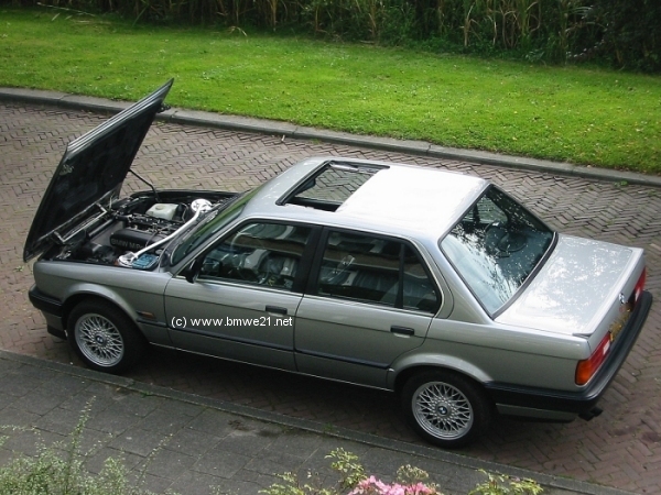

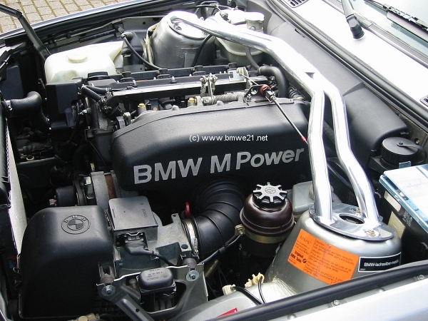

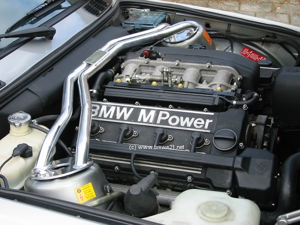

"Italy -1987. As a result of extreme taxes on cars with displacements of over 2 litres such cars weren�t very polular, especially those cars that only just exceeded the 2 litre mark, like the M3. BMW Motorsport decided that there had to be a special car for those speed loving enthusiasts that didn�t want all their money to go up in tax smoke.
With a slightly shorter stroke the E30 M3�s S14 engine displacement dropped to just under 2 litres. The shorter stroke took the rough edge off the engine, but still gave enough torque for creamy power-delivery from 1500 rpm upwards. The car was called 320iS and it was available as a two door with full M-Technic bodykit as well as a decent four door saloon that looked as regular as a 316i".
Poza 1
Poza 2
Poza 3
Poza 4
Poza 5
